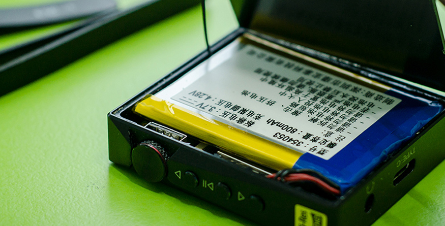

First that we see is 800mAh, 3.7V 1S LiON battery with 4 wires connector which is additionally protected and locked at place by the small aluminum cover with the screw.
Unscrew it first and the next step is to remove the battery.
Battery is retained by the adhesive layer applied to the board shielding cover. You can first remove the battery together with this shield (it is held in place by tiny aluminum clips located on its perimeter on the board) and than separate the battery from shield by slightly heating it and inserting thing plastic object in between. But if changing the battery is not among your quests — do not do that and just leave it aside. disconnect battery by gently pulling the wires straightly up near the connector with thin pliers.
Apply even force to all wires at the same time to protect them from stripping or tearing.
